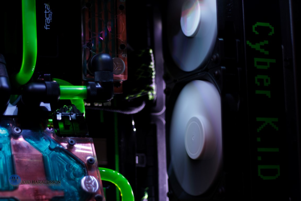

installed the waterblock on the 970 card
and
did finetune the cosmetic aspects of the gpu a little with some custom vinyl and some acrylic :-)MyndMyndMyndMynd
working on Cables and led's today.
Have to train the cables forst though.
*tightfit.
Also speedmatching the two pumps.
one is an Alphacool D5 and the other is a
alohacool Dc LT.
MyndMyndMynd
Almost there...
Myndalmost there.....

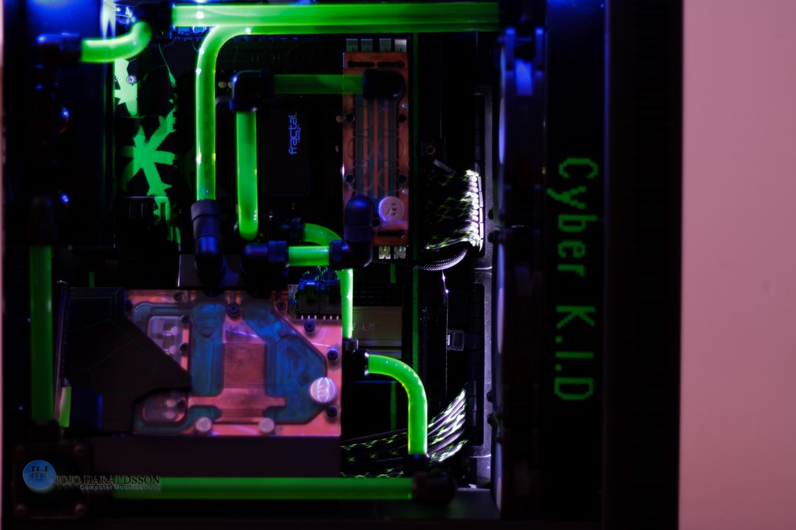

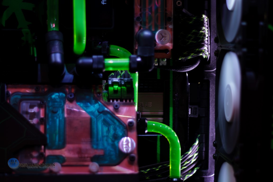

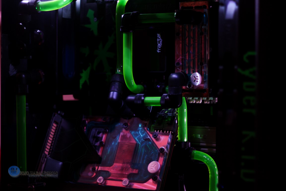

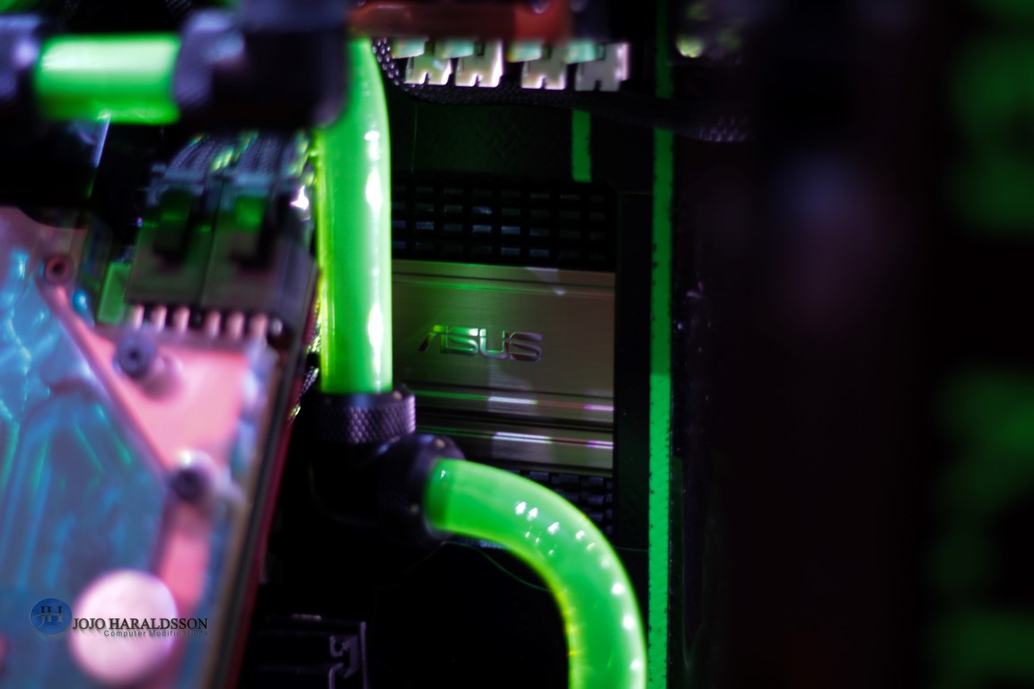

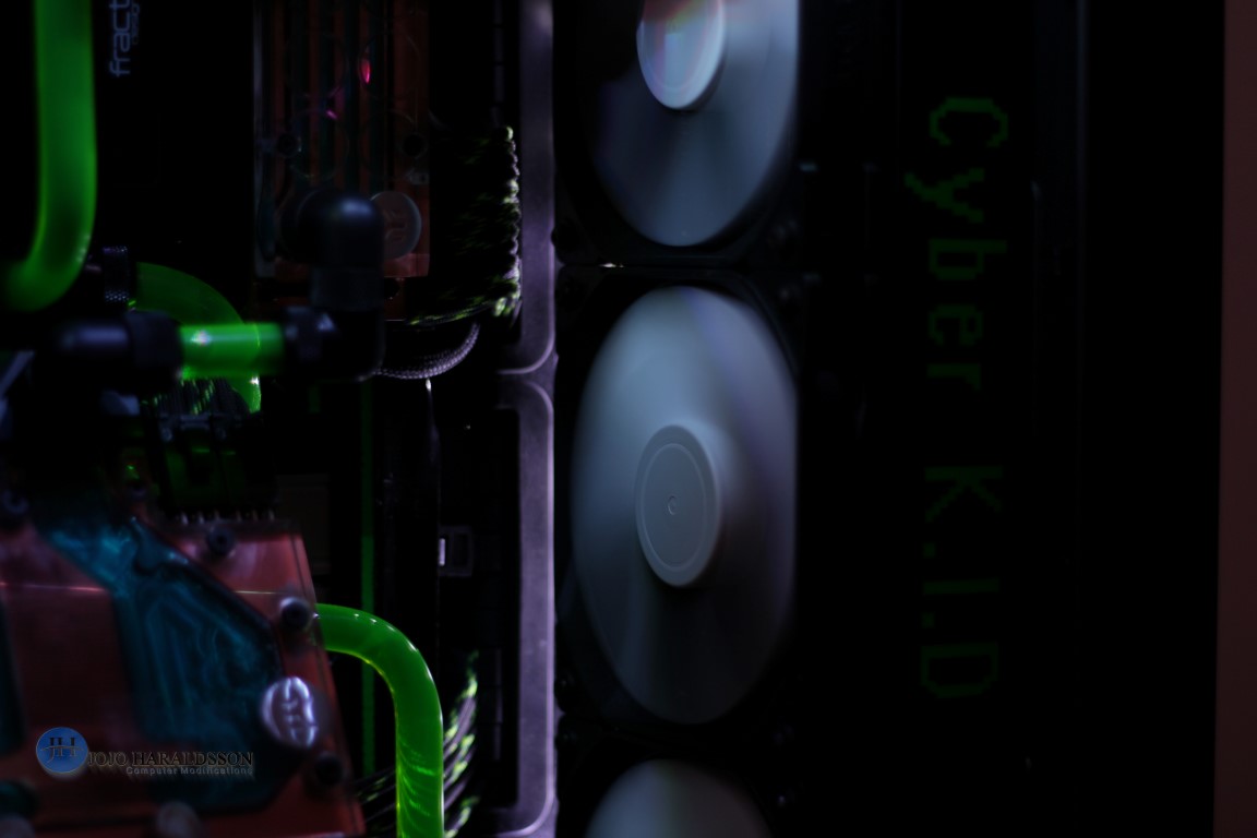

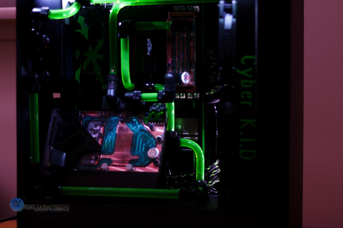

Hey everyone i would like to share with you the final outcome of my just finished work on the Fractal Design ´s Define C Computer Case.
Hope you like the final pictures.
Thank you for checking out my Buildlog.
Until soon!!!
MyndMyndMynd
MyndMyndMyndMyndMyndMyndMyndMyndMyndMyndMyndMyndMyndMyndMyndMyndMynd

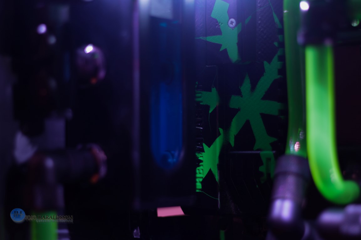

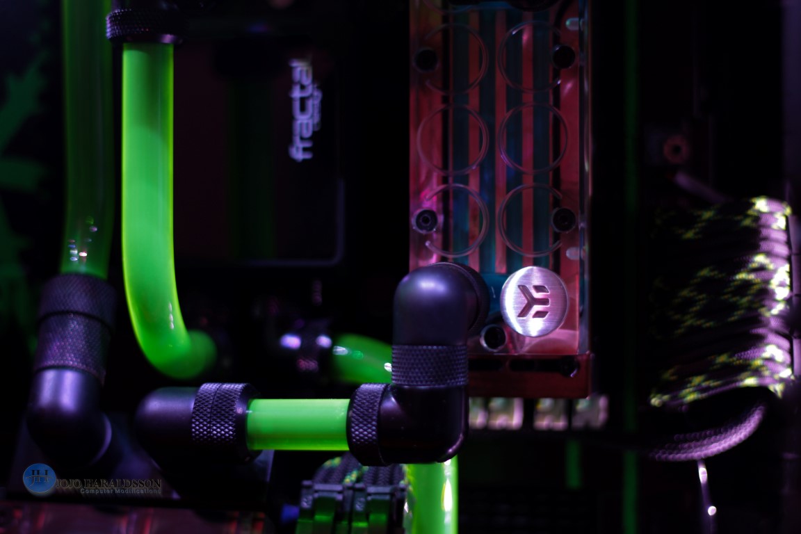

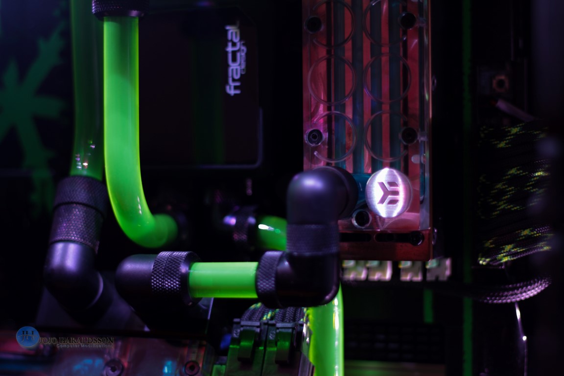

Pósturaf jojoharalds » Lau 21. Jan 2017 20:26
Hér eru nokkrar LED myndir :)
möguleiki að nálgast þessu led kerfi með mísmunandi stillingum og á góðu verði,
á Icemmodz.com
http://www.icemodz.eu/#!/Lighting/c/5346676/offset=0&sort=normal
